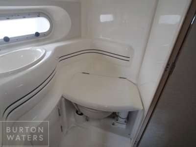

Where's it leaking from? View attachment 165319

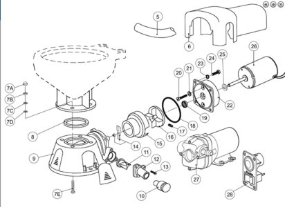

I’m hoping it’s around the rubber seal (18)...at least in that general area. It’s a bit low to the ground in a tight heads to get a real good look...especially as I would need to be laying down while flushing....when I locate a rebuild kit, I will disassemble it and the true horror will be evident
Hopefully a simple O ring change... you might also get away with a temp fix with some decent silicone.
I found a rebuild kit in a local chandler....but all the research in the world doesn’t give you enough details as to whether it’s for the motor and toilet....or just the toilet. Anyhow at least I can make a start. Only problem is we are living on the boat for the next three days...so I am not sure if I will wait until we return or just do it and hope for the best
