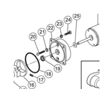

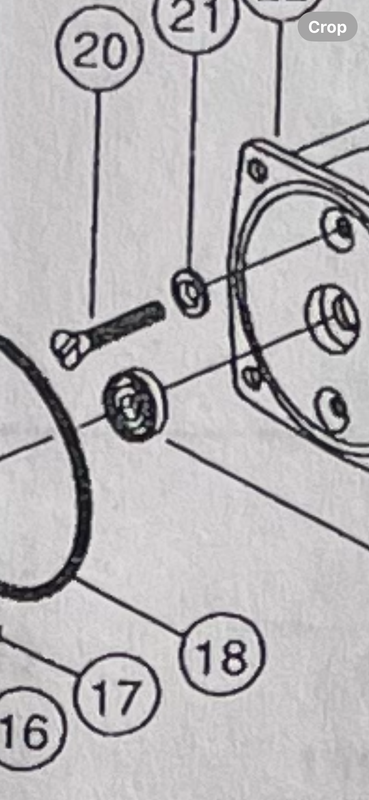

Hi Bouba,
I have a small leak on one of my Quiet Flush Electric Toilets, also from the shaft seal, the seal fitted (19) to mine has the flat side of the seal installed towards the motor side of the housing, with the spring side seen once inserted - is that the correct way round that you fitted yours? I ask because I am doing the job tomorrow....!Doc1.jpg
Bouba
6 Sep 2016
42,696
SoF
Hi Bouba,
I have a small leak on one of my Quiet Flush Electric Toilets, also from the shaft seal, the seal fitted (19) to mine has the flat side of the seal installed towards the motor side of the housing, with the spring side seen once inserted - is that the correct way round that you fitted yours? I ask because I am doing the job tomorrow....!View attachment 168526
Hi John...it was something that I agonized over for ages....but yes, I’m pretty sure that is what I did...put it in so you can see the springs...I used the same diagram as you have used...but looked for the highest definition one I could find...till I convinced myself that I could see the springs in the drawing. If I wake up in the night with a sudden realisation that I am remembering it wrong..I will let you know 😜

In the interest of safety...for weeks after, I would always close the toilet seacock on the thruhull when I left the boat...until I was happy that the repair was perfect

Thanks for the prompt response.
It's the guest toilet, we don't have anyone out this visit so I thought it might be a good time to strip it down and fit new seals. One of those lovely winter jobs...!o_O
Bouba
6 Sep 2016
42,696
SoF
It’s actually an easy job...make sure all of the old seal is out (it’s made of metal)...that’s where I went wrong ... I couldn’t see the metal remnants of the old seal still in place...until I used a magnifying glass...as long as you have a little space to work and better eyesight than me it’s a very quick job👍
