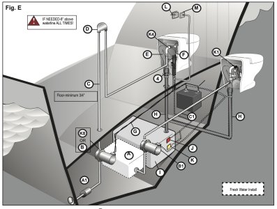

I'm a little confused by the comments above about the proximity of the double duck-bill valve to the macerator. Below is the installation diagram for the Tecma Nano ...
The double duck-bill valve is inside the part labelled "4" on the diagram, connecting the discharge from the toilet to the pipe leading to the holding tank. However, it should connect to part "E", which is the Short Discharge Tube, and not directly to the macerator pump. In practice this "short" tube is about 20-25cm long and so the valve should be a reasonable distance from the macerator pump. If there is a problem with solid matter reaching the valve I would be inclined to check the bowl is filling correctly with enough water and the macerator itself is operating properly. It should be at close to full speed before the bowl starts to drain, so anything reaching the duck-bill valve should be fully liquidised.
