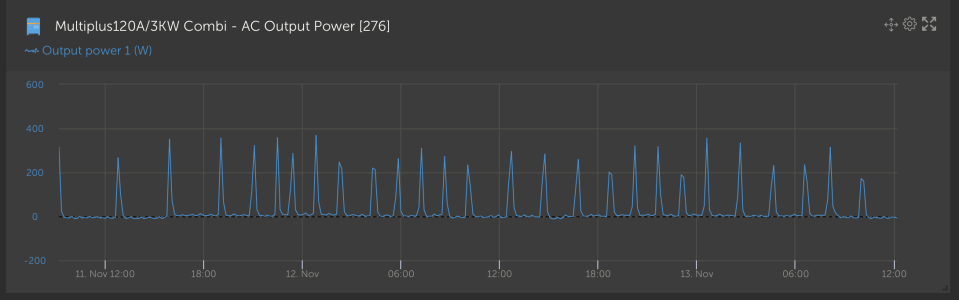

This is the power usage profile of our Meaco junior desiccant dehumidifier on board our boat in Scotland. It is permanently supplied with power.
This is over two days last week, I haven’t used this week data because I’ve had bar heaters on these past two nights. You can see that the dehumidifier comes on to sample the air and then switches off very soon afterward. It is on the lowest setting and maintains 66% RH. Total power usage is 9kw/week but that includes the charger on float/storage. So about £4/wk to keep the boat dry, that’s fine with me. Personally I think dessicant dehumidifiers are much better on board, I wouldn’t use a compressor type.
