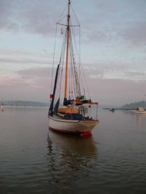

A gaff rigged boat is of course different and she will, regardless of size, have single spreaders so that the mast hoops or lacing can get up and down the lower mast, but the single spreaders will be substantial and they will have “spreader lifts” from the lower mast head, or the equivalent position on a pole mast, to the tips, with their own bottle screws.IMG_4181.jpeg
