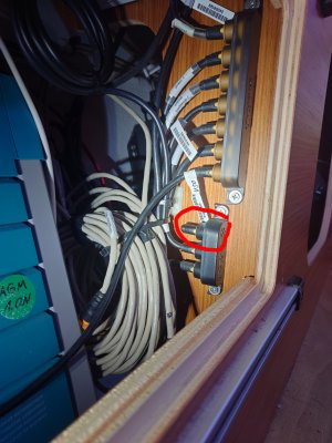

Thanks for the replies. I'm sure I don't have to state that I'm starting from a very low knowledge base. The boat has two Zeus plotters, two T41s, wind, Airmar, Autopilot and V50 VHF connected to its NMEA 2000.
What, I think, to be the backbone connections are photographed below but they have a different plug to the new T41 I hope to install. For starters, is the unused connection, circled, a valid port for the T41?backbone_copy_1209x1612.jpg
The one you indicate appears to have a 120 ohm terminator in it, which is part of the network requirement.
The T41 does connect into one of those multi connectors but you need a micro C to simnet lead (see link below). Rather annoyingly, B&G only make that connector block in 3 way or 7 way (you have one of each in your photo). It may be easier to swap the 3 way for a 7 way (you can leave unused sockets empty but you do need to plug the terminator back in).
You'd end up using four of the 7 ways in the new block.

That's really helpful, thank you. Now I now what I need and I must learn not to be so wildly optimistic about 'simple' upgrades.

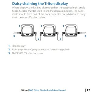

If you plan to fit the T41 near the existing one, all you need a a micro C to Micro C, daisy chain the two T41s.
Does this work? The manual (link above) advises daisy chaining them only if they remain a series component of the backbone rather than off a drop cable so the OP should determine how his existing displays are currently connected.
