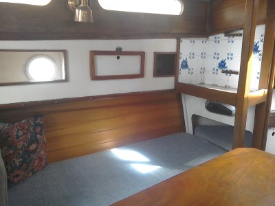

Your boat must be very damp. I have never needed to seal cut ends of T&G, just varnish. The removable panels in the photo were at least 20 years old - and that is a wooden boat.

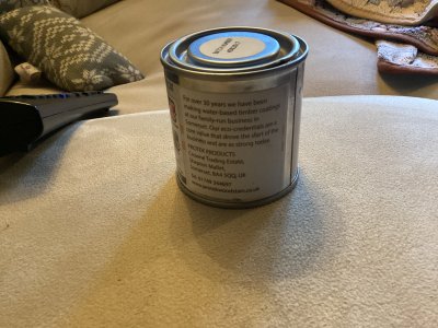

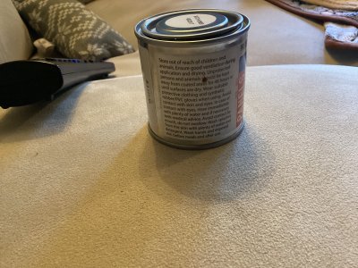

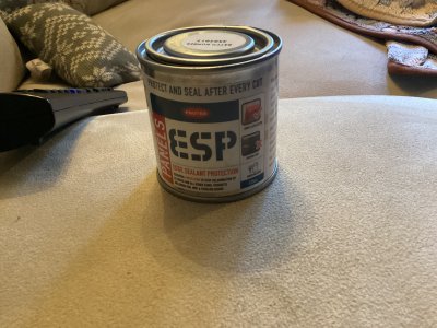

I bought some latex based paint from the local wood emporium that is designed exactly for the purpose of sealing the edges of plywood etc. If interested, I have the tin in my garage so will take a photo for you.
