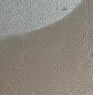

My present boat (16 years old & counting) uses this stick on leather look product for areas too awkward for a rigid headlining / hull side slats. Spend 6 months aboard cruising each summer and have lived aboard when between jobs/houses. No mould, so far:
Thats not a bad idea at all, thanks. I might even be able to use some of the architectural vinyl I used on bulkheads, hadn’t even crossed my mind! Then I just need to find some kind of flexible trim to transition between the straight edge of the panel to the vinyled curve.
