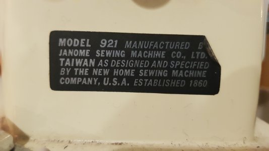

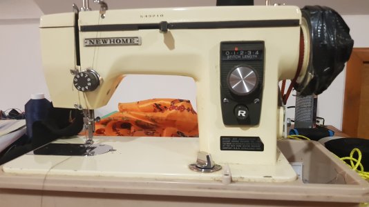

I use my wife's New Home. Modified with lead strip wrapped round the flywheel for extra momentum. V92 has lasted well on stack Pac and sail cover made 14 years ago.

I put new Windows in my sprayhood using my wife's New Home machine. It wasn't that difficult. The important thing is to develop the skills to manipulate and guide the cloth. Muscle memory and all that. It usually takes some time to get back up to speed after a lay off.

My wife bought the New Home 50 years ago. It's never been serviced. I oiled it a couple of years ago. It's bloody heavy. I can hardly lift it. Several on eBay for not very much.
