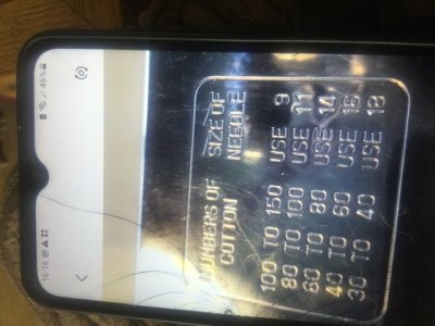

Hi guys this is the sizes of what the machine will take , what size do I need including thread and where would I buy . Thanks
