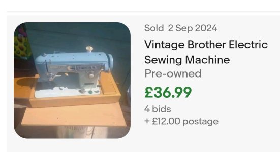

Wow.. that's not worth that at all..
My first thought was that I passed one of those on to sbdy at the marina a few years back for about £25 from memory.
Looking at eBay for sold items.. doesn't this one look similar?
FWIW... when adjusted right, cleaned and oiled on the right places, it'll do the job (a few layers of Sunbrella) much like any other small machine.

There's nothing there that screams "sailmaker" to me. It's just a vintage Brother sewing machine and an over-priced one as Martin_J has just pointed out. You should be able to get a vintage Japanese Brother or Janome for under well £100. Some people service/refurb them and sell them with a 12 month warranty. Even those you can pickup for under £200.
