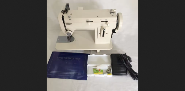

We got a Sailrite-alike. 9" version with the big wheel. All the Sailrite parts fit. Email them with your delivery address and ask for a quote 'delivered'. The advertised price is nonsense, but the real price is a fraction of a Sailrite.
Hand Held Sewing Machine - Buy Electric Portable Household Sewing Machine,Zig Zag Stitching Machine,Flat Bed Sewing Machine Product on Alibaba.comView attachment 181571
I've got one those too. Now heavily modified but a solid reliable and simple machine. Got mine on Ebay for £40 some years ago.
