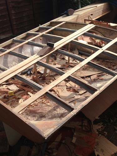

Got quite a bit done today. First up, a rough sand of the inside of the back tank and a load of epoxy over it. No, I didn't get the finish perfect...this will never really be seen again so who cares?

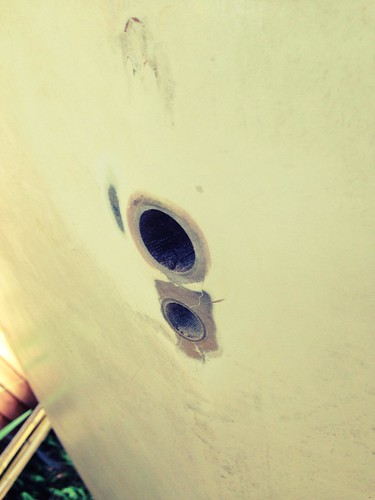

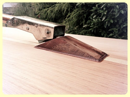

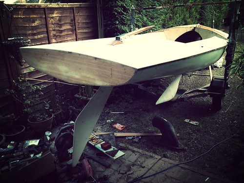

Next it was time to fit the new rudder tube. It's about 40mm further back at the bottom, and 100mm further forward at the top...very different to the old vertical one...which seemed to be made out of Bakelite!
There was a lot to go wrong here but with strings marking the centreline, jigs comparing the two rudders and a bevel gauge to transfer the rudder shaft angle to the boat, it seems pretty much perfect. Rudder is vertically in line with the keel, the trailing edge is vertically below the transom, and the top edge of the rudder is parallel with the hull. Happy days!
Pic shows larger diameter angled rudder tube exiting behind the old one...

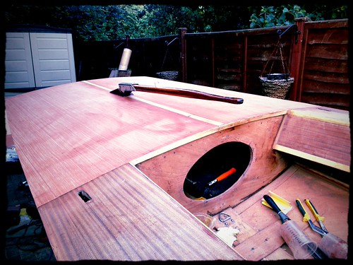

I also got one half of the stern redecked...the colour match isn't great but tbh theres so many different woods on the boat it's not the end of the world. The old stuff was badly damaged, badly repaired, and this is a big improvement...and now I've sanded the existing decks they've come up redder anyway.
Epoxy certainly goes off quickly in this heat!

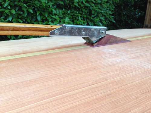

Anyway, another very productive evening and a major milestone...the rudder conversion is done! SWMBO held the new rudder in from underneath and raised it and lowered it out the tube an inch or two whilst I carefully took the rudder tube down with the belt sander to exactly the right length. I then made up a fairing piece (no idea what it's called but all the boats seem to have them) which is slightly oversize to cover the old shaft exit point and epoxied it in place. The rudder does want a bit of fairing as it has a dose of the pox, and the OCD in me wants to make the bottom of the stainless tiller hood a bit more parallel with the brass block underneath and fairing piece...shaving the tiller inside it a bit will achieve this and also get it sweeping a bit closer to the deck. It also needs the new bushes gluing into the ends of the tube properly now everything is in place.

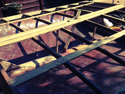

Ok a bit more done. Truth is there's loads of fillets in the cockpit that need sanding, by hand, because you can't get any tools in between the ribs, but at the moment I'm trying to find any excuse to do anything else!

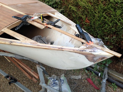

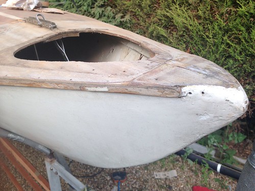

I erm'd and aahh'd about replacing the foredeck, as there is some damage here and there. However that would be a big job, and the old one does add a bit of charachter. However the front piece around the chute mouth does need replacing, as well as the slightly odd shaped nose! In fairness, my iPhone has made it look an odder shape than it is, but it's still rubbish...

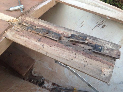

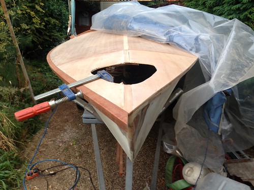

Front of foredeck removed, and a bit of rot under the forestay fitting. Just the hardwood trim piece, but needs to be replaced...
New nose built up with a mix of microsphere blend and colloidal silica and new trim piece added. I'll deck the whole lot and rout the hole for the chute mouth. Trust me, the stem is more curved than it appears in this pic!

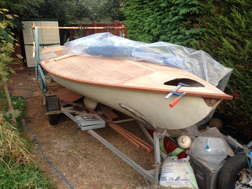

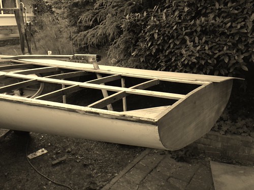

Right then, been a white since I've updated this thread. Lakesailor previoulsly asked if I'd had the "box of matches" moment yet, and I said "oh no, never had that". Erm, wrong.

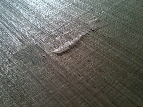

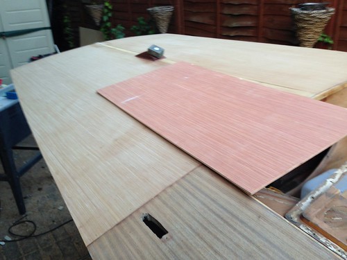

As per previous updates, I'd decided to do the aft deck in WBP ply rather than marine. WBP is "Water and Boil Proof". As the ply was epoxied underneath, and would have 7 coats of varnish on top, and be on a boat that was drysailed, it should be ok, only prolonged, unprotected immersion being a problem. And it would certainly be fine in my back garden, away from water, covered, during the hottest summer in living memory, right?
So coming back from a two week cross channel cruise and finding my new deck looking like this, didn't go down to well with me...(understatement of the **$$%¥ing bloody century!!!!)

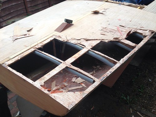

So after a visit from a somewhat horrified timber yard boss, a new sheet of guaranteed BS1088 marine ply turned up. Best not to think about the wasted weekends, wasted epoxy, oh...and this, which was just heart (and deck) breaking...
Unfortunately, as I'd done such a damned fine job of epoxying down the new deck, there was a bit of damage to the boat getting it off again. Still, the new one is now on, and as long as you don't look too closely, it's not too bad...

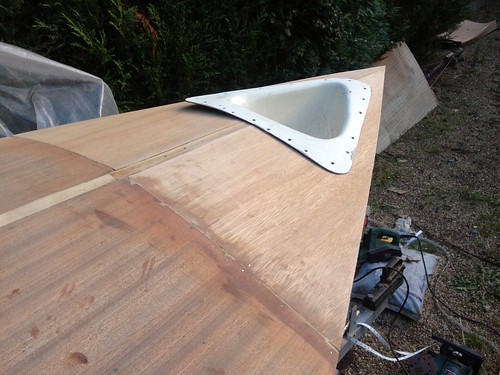

You probably remember the horrible bow...
...well now it's starting to look a bit better, and I've started to test fit the gunwales...we are making progress, but sadly, so is autumn...the race is on to get a coat or two of varnish on before it turns too cold!
