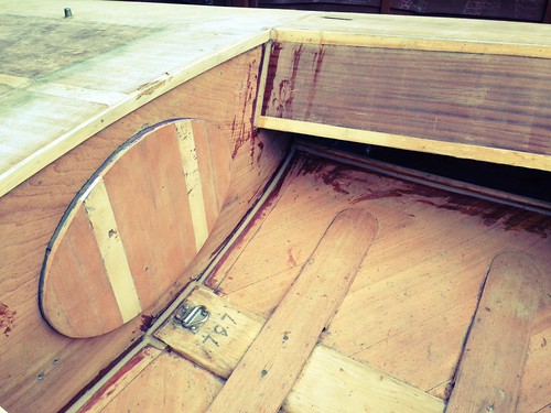

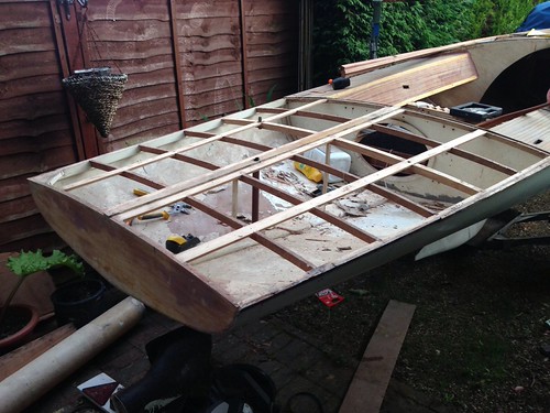

Light evenings and the rain holding off today has resulted in a bit more progress. Most of the heat gun stripping is done...the cockpit floor was a complete mish-mash of varnish, polyester, epoxy, deck paint, araldite, and sikaflex. The wood is generally excellent, even if it has taken days with just about every variant of electric sander known to man to get down to! But worth it I think.

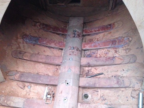

I lifted the upper hog today and removed all the glass tape from under it...again it's all solid, however most of the little leaf-sping frames need repairing. They've been done before, but badly...small pieces with the grain going the wrong way! She may be old but the plan is to race her properly and not leave the cover on just because it's blowing 20kts, so all this structural stuff will be done properly.
Hoping to have the cockpit fully sanded and ready for epoxy repairs by tomorrow evening.

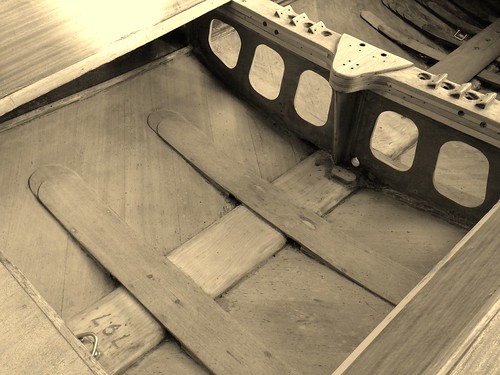

Quite an important day, as I was able to start one of the important jobs, and also start rebuilding rather than just stripping and sanding. There's still some goop to get off right at the front of the cockpit under the foredeck, but we're nearly there.

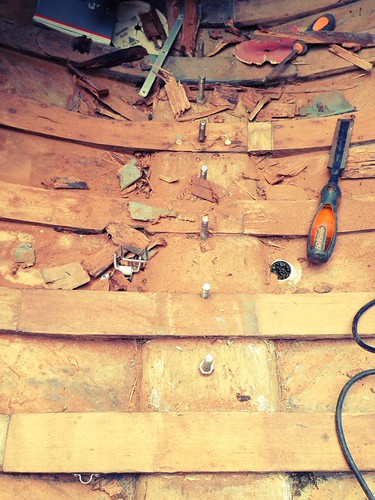

Anyway, most of the ribs are broken on the stbd side and as mentioned before have bee repaired very badly. So it was in with the chisel to chop out the rubbish (only 2 at a time so as not to lose too much strength during the repair with little old me running around in the cockpit)...
...and in with new pieces, a few laminated layers of 5mm ply shaped and bent to fit, and epoxied in place. It's the two in the middle of the pic...
Lastly, some fillets to the aft cockpit, there will be lots of these giving extra strength on all the joins. Experience from wooden Fireballs shows areas like this are under quite a bit of load, especially when the driver gets overexcited putting the kite up (halyard goes back here). Also the side "tanks" were not joined to the aft bulkhead...sorted now.

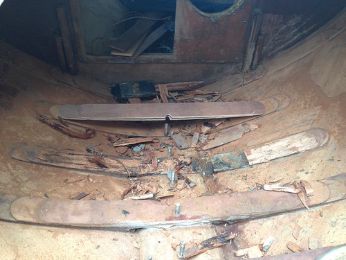

Two more broken ribs cut out tonight...including the worst which had to be almost totally removed...
...and replaced. Parcel tape around the upper hog so the epoxy doesn't stick to it!

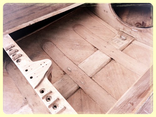

The forward rib, against the bulkhead, was also broken. And it had rot under it. Bugger. Dug it all out and epoxied the new rib in, with 6 layers of glass tape to add a bit of substance in the area around the hog. I am filletting all around the ribs and sanding them smooth...long job but nearly done.

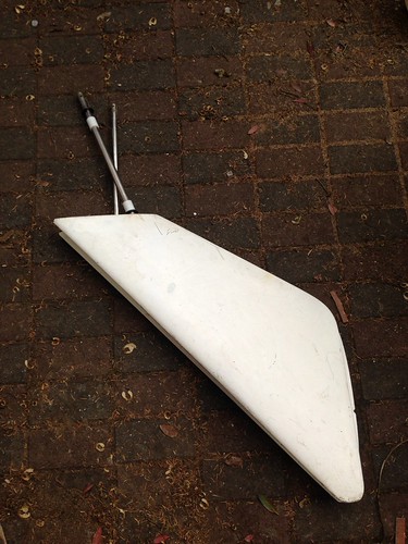

I decided that the stern deck would definitely need replacing, and also to fit a different rudder. The early 15s had vertical rudder posts and fairly unbalanced rudders, which create weather helm, and also drive the nose down on the bearaway when heeled. The later type has an angeled shaft, also set further back in the blade, which helps reduce this. eBay came up with a rudder for £50...seemed fair enough. Here are the two laid over each other...big difference in angles.

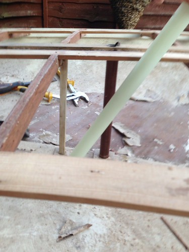

I ordered the new rudder tube and new bearings from Ovington Boats...the tube will go roughly here (top further forward than the old one, and bottom further back) and I will swap them over and seal up the holes this weekend. The new shaft and tube are longer and thicker than the old one...
