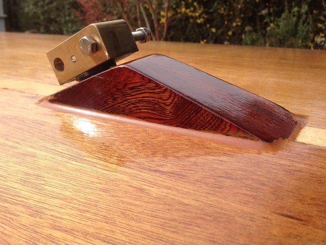

I've drilled out all the chainplate holes oversized, filled with silica-rich epoxy in preparation for drilling out to the right size and bolting the chainplates in for good. I've also done a similar thing with the bow fitting...there's two s/s straps which transfer the loads down from the bow fitting on the foredeck down to the keel/hog, however they were not fixed on very well so I've been making a few modifications, using bolts instead of screws. However, this did mean a trip into the bow tank...actually, it's more like a forepeak in there! I'm nearly 6' and not small...and I could probably sleep up there! Might be a bit different when the spinnaker chute and bouyancy bags are back in though...

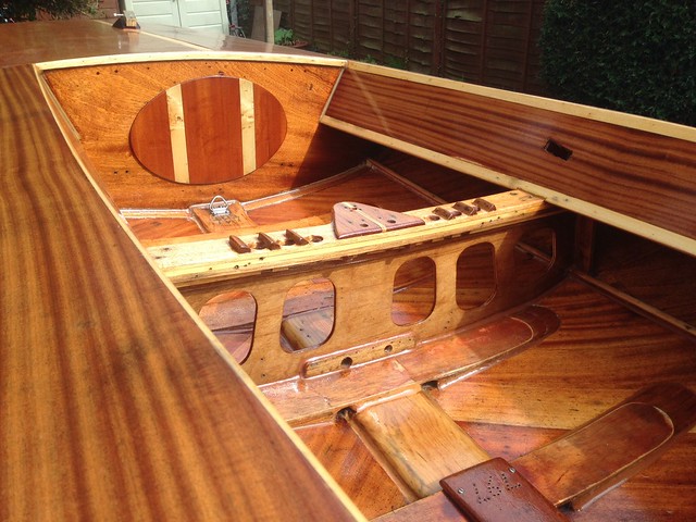

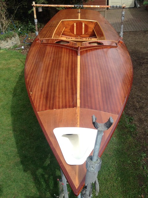

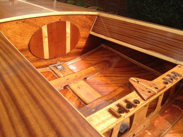

Varnishing is done. It's not perfect but it will do...for something done outside over the winter it's okay. I'll let this harden for a week or so and try some 3M compound on it to get rid of the dust. I'm actually more annoyed about the wrong coloured filler in the epoxy on the foredeck join on the stbd side...looked fine in bare wood but obviously the wood has darkened and the filler hasn't.
The foredeck has come up ok, I've not really tried to hide the damaged bits which are visible along the gunwales...at the end of the day the boat is almost 50 years old and I want her to have some character and battle scars to offset the modern modifications and carbon bits rather than a pristine deck and a "Trigger's Broom" scenario!

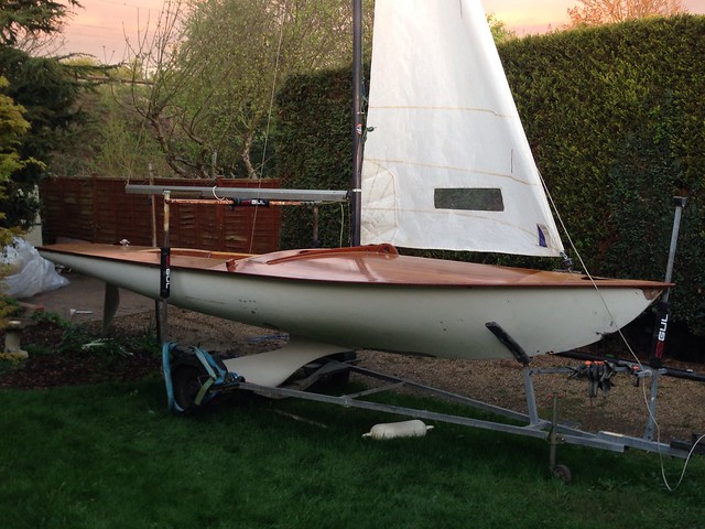

Quite a big moment tonight...I got the mast step in, the forestay fittings on and the mast up. More to the point, with 400lbs of rig tension on the shrouds, nothing went bang or creaked, which is a result, as when I got the boat, she was incapable of taking any rig tension at all as the port shroud point was in a very bad way. The additional carbon has probably helped here!
On with the filling, fairing and painting, and also the fit out. Getting the mast on now was quite important as I wanted to make sure nothing folded up under load, before I painted the hull, and also as the mainsheet bridle and some other things will need accurately positioning on what is a new stern deck (with no old holes to reference).

quick techy question pls.
Does your trailer have brakes, or just plain suspension units ?
It's an un-braked trailer. The boat "only" weighs 300kg so brakes might be a bit OTT. What makes that trailer quite clever is the fact it's designed so the keel is below axle height, making launching and recovery easier and keeping the centre of gravity lower for towing.
