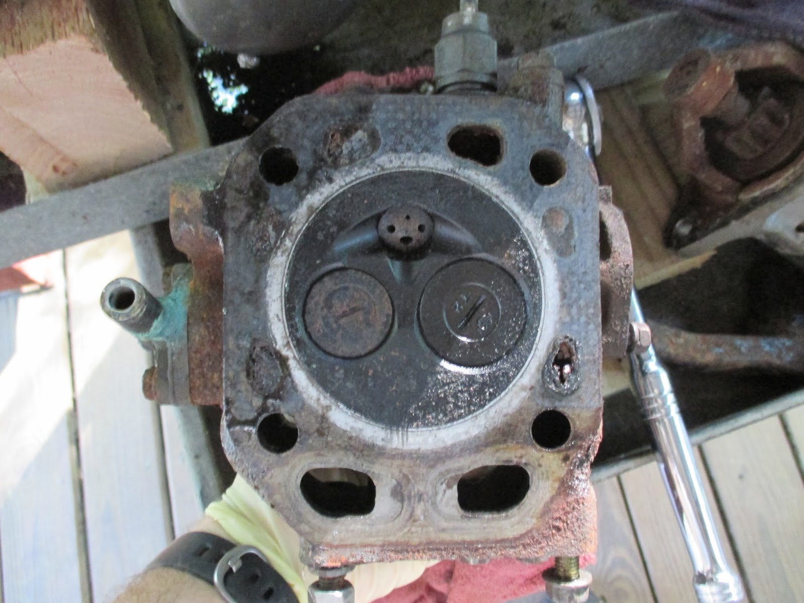

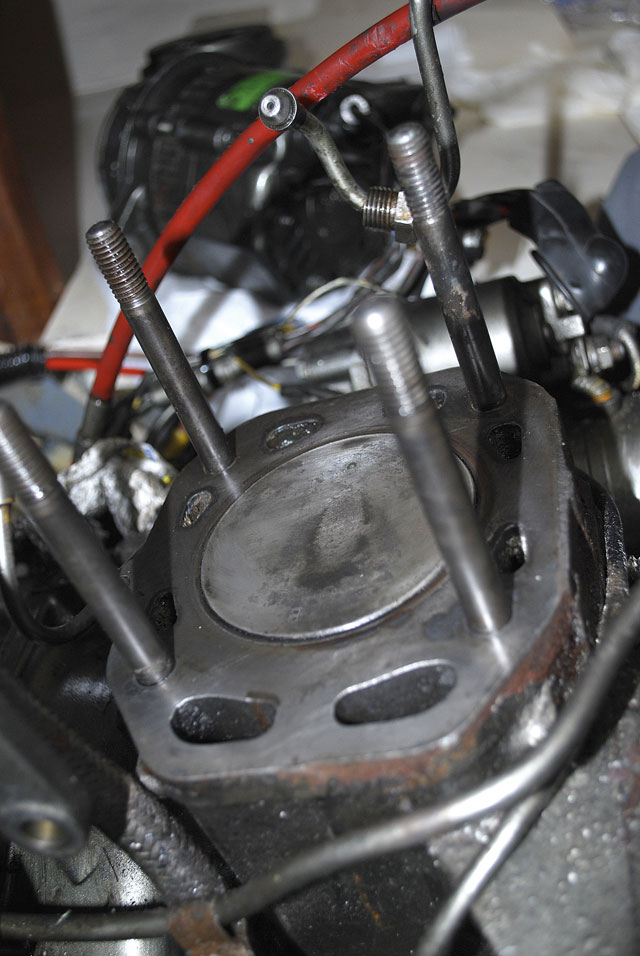

Just to keep it relevent, a Yanmar head and piston (note basically flat and flat - it has a pre-combustion chamber)
