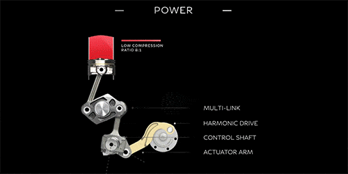

Slightly off tack the late and great Ricardo fiddled with VCR and is now being developed to enhance performance.
A variable compression ratio engine is quite easy to design but the cost to manufacture puts it out of reach for normal engine use.
Super charged of turbo charged is a better more economic way of increasing the air / fuel charge to gain more power
Even better is energy recovery systems of hybrid engines or even electric drive once properly developed
