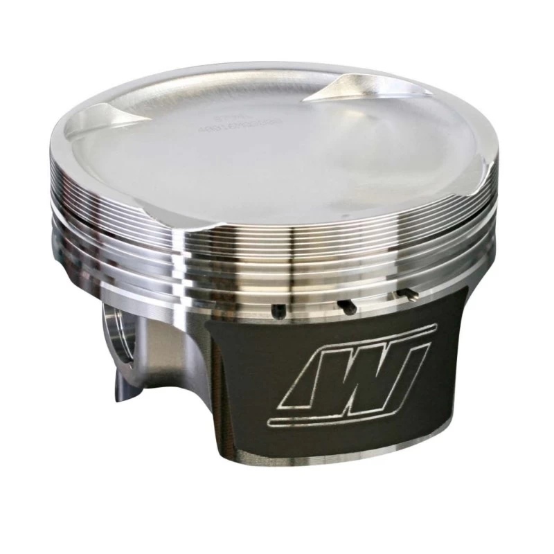

OK ..... above are photos of two pistons. Let's assume that we don't know anything else at all about either of the engines that these pistons are taken from, other than that the two engines have different compression ratios.
Now, the question is .... which piston is from the higher compression engine and which is from the lower compression engine?

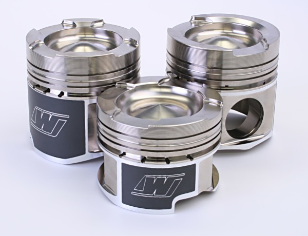

Here's some diesel ones.
Both the pistons fit into the same engine without any modifications.
The flat one makes the lower compression ratio, the raised one ... raises it. Obviously a dished or bowled one would lover it. In this specific case, the cylinder head has a semi-hemi shape. A full hemi(spherical) might use a piston like this;
Same bore, same stroke ... different SHAPE of combustion chamber. The dome SHAPE require to create a sufficient (the same as the above, funnily enough) compression ratio. I suppose strictly speaking you could argue that the shapes "don't make the compression" or something, but their shapes and their match determines the compressed volume, that determines the compression ratio.
