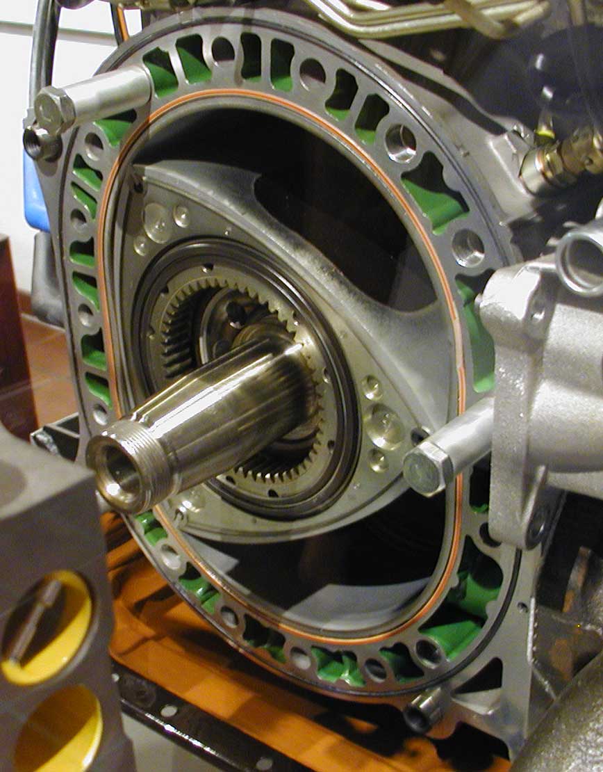

The answers would be the same for an IOE engine as any other (Wankels irrelevent in this discussion)

I thought so ... arguing at crossed purposes ........... load of rotary engines the lot of you
