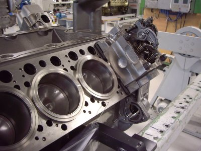

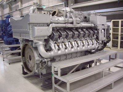

Here are some photos of the CR2000 engine from the MTU workshop in Friedrichshafen (Germany).
Sometimes it is nice to see the engines without any paint.

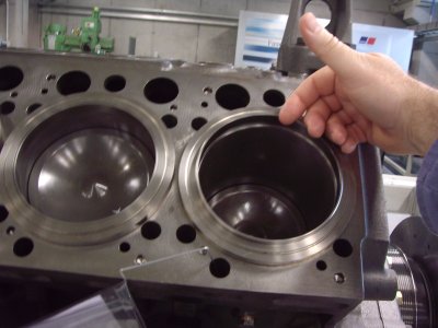

This shows the size of each cylinder
All the cylinder heads are modular so can be removed individually.

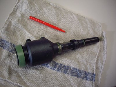

Just to appreciate the scale, this is one of the injectors (I'm glad I have only got 16 of them - they must cost a fortune to replace)

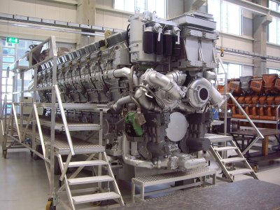

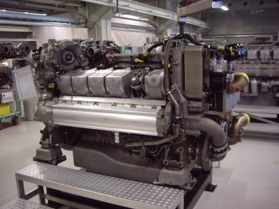

The CR2000 engine is one of the smallest that MTU make.
They also have a CR4000 and 8000 ranges (4 litres per cylinder and 8 litres per cylinder respectively)

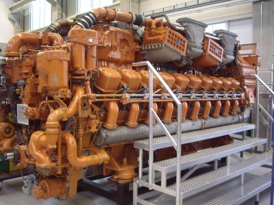

Here are some photos of the bigger ones

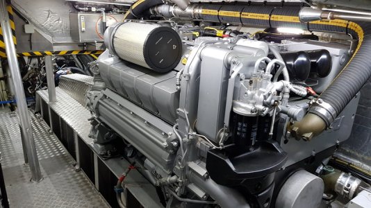

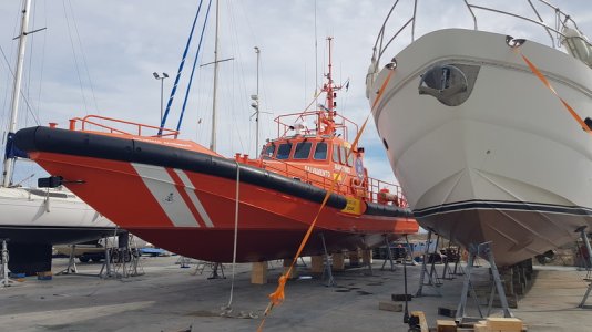

Whilst I' on the subject of MTUs and specifically the CR2000, I always take an interest whenever I see them about.
For example MTUs were fitted to this Spanish Lifeboat (Salvamento) - in the yard next to my boat.
I got to know the crew so they arranged a tour for friends and I - this is the engine room - CR2000 V10
I just thought you might find it interesting - and put some pics to the model numbers that have been quoted.
That was super interesting! Thanks for sharing. i assume they have a “head gasket” per head? Must be an interesting shape looking at the height and lack of gap between cylinders?
looks like they use an "O" ring on the top of the cylinder sleave.

That’s amazing precision to seal on the cylinder sleeve and the block surface. No room for error there.
I edit
Looking again there is some thick material under the cylinder head which I guess takes up any errors or tolerance build up, so you can pull well down to create a good seal on the sleeve while letting the ‘thick material“ look after the block seal.
Interesting that it’s push rod but I suppose with a slow revving engine valve bounce doesn’t figure.

@DavidJ, yes it's a pushrod engine - central gear driven camshaft. Nothing unusual about that - it's a 2450rpm engine. Cat32 and 32B, MAN2000, Cummins QSK50 and other QSKs, Baudouin 12 are all the same and that pretty much covers every plausible engine in the 2000-2600hp zone.
