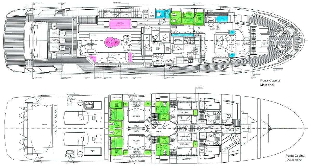

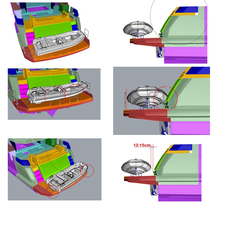

The marbled areas GA, and the tender 3D models emailed to me this morning by Sanlorenzo are below, just to give a flavour. In the marble plan, the 3 colours denote the 3 different marbles that will be used on the boat. The galley will have Dekton rather than marble, and the crew areas and flybridge bar units will have Corian, so they are not on this GA. The marble will come from the Carrara mountains, a few miles inland the boat building towns in Tuscany. In the tender renders, the bottom right hand corner is one we will use.
