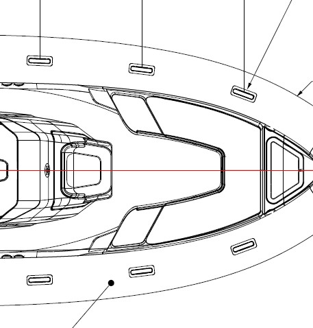

Very nice RIB - it sure does look very high quality from the pictures. I imagine that the U-seating at the bow is intended for 4 people. If that is the case, then I thought the second set of hand rails at the bow seems to be placed a bit far aft (see red oval in the picture below). Wouldn't it be more comfortable for passengers with a few more (or wider) hand rails? This is a genuine questions as I have never been onboard a RIB of this caliber, so I don't know if it's needed (or if the hand rails are actually cleats? :unsure:)

You're right about those handles (they are soft handles, not cleats). I have just aksed Ribeye to put 3 each side one extra in the middle of each pair shown on the render - that will be no problem as a spec change.

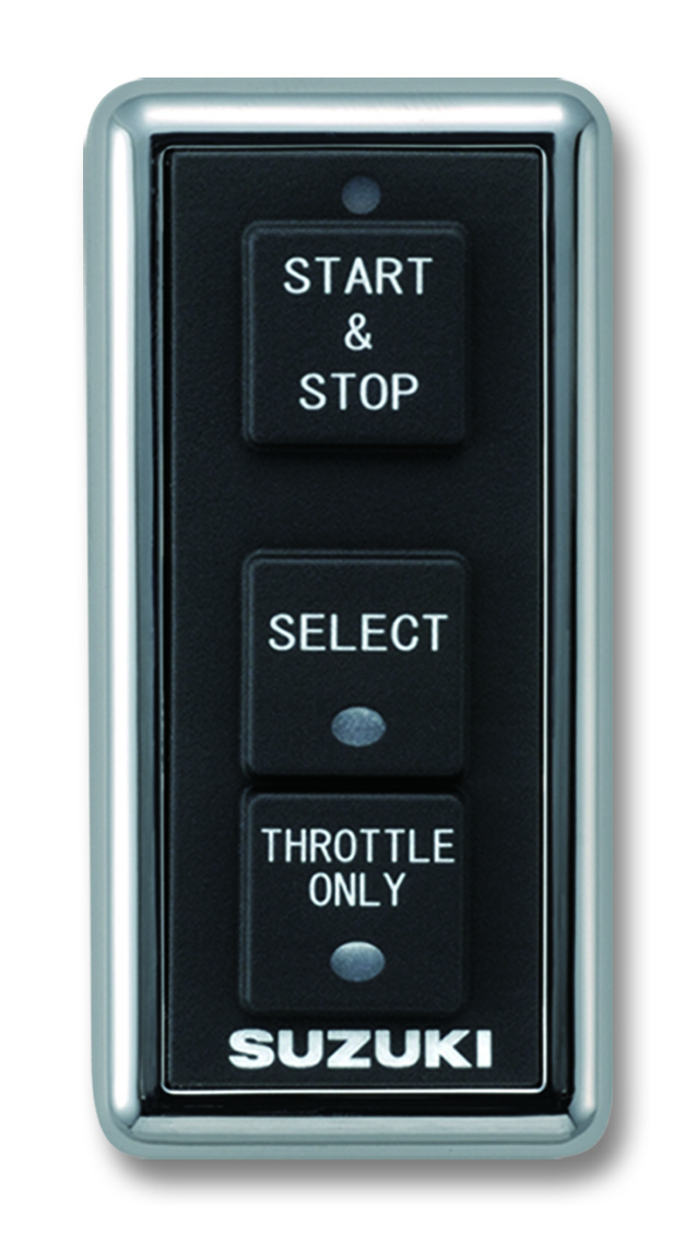

It's a fairly standard thing on digital engine control now and replaces the old mechanical shift disconnect which was usually achieved by pushing some sort of button on the side of the remote box which would mechanically decouple the shift cable from the throttle levers. The main advantages of the digital system being that the throttles retain the idle detent rather than just flopping around since there is no mechanical disconnection, and a positive action is required to disengage the neutral lock rather than just pushing the throttles back through the neutral position.
On Helm Master the button is labelled "Neutral Hold". Suzuki call it "Throttle Only" mode.

Thanks Roa123.
You're right about those handles (they are soft handles, not cleats). I have just aksed Ribeye to put 3 each side - one extra in the middle of each pair shown on the render - that will be no problem as a spec change.
@roa123, Ribeye have already this morning updated the build spec to include your extra handles on the tubes near the bow seating, and sent me this drawing :)

So if
You press throttle only
You go into the forward gear indent on the throttle lever
Then you stay in neutral and if the lever is knocked forward the engine revs and no harm is done.
This I get.
But if you return to neutral position on the lever, on my boat this cancels the neutral hold.
Are you sure you have to press to un-cancel the hold?
Because on mine if you were at the forward indent and knocked it full astern, it would cancel the neutral hold as the lever passes through the neutral position.
Just as the old mechanical levers used to do.

In my limited experience of fly-by-wire boats (which is mainly Suzuki), yes. It won't come out of throttle only until you are in neutral and press the button, regardless of whether you move the throttle levers between neutral and forward/astern position. In fact I'm pretty sure that if you do select forward/reverse gear while you are in throttle only you get a warning beep to remind you.
From the Helm Master EX DEC manual:
Neutral hold switch​
When activated, the neutral hold switch allows opening the throttles of all engines, without engaging
forward or reverse gear.
How to operate
1. Move the remote control levers to the N position.
2. When the “NEUTRAL HOLD” switch is pressed, the beep sounds and the LED turns on.
3. Moving the remote control levers forward or reverse allows you to open and close the throttles.
How to release
2. When the “NEUTRAL HOLD” switch is pressed, the beep sounds and the LED turn off.
So it sounds like it works exactly the same way as Suzuki's system.
