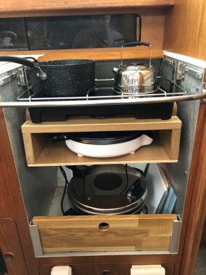

Chris, your opinion is valid and I agree a LifePO4 (LFP) installation may not be for everyone, at least for a while yet. The reason we chose to go down this route was to have a mix of gas and electric cooking. During 2021 we halved our gas usage using an electric kettle, toaster and induction hob. Last winter we upped the solar to 590w and have recently added another 110w. This is our primary charging source and provides sufficient power during the summer to run the whole yacht including cooking. Last Spring we moved to an all electric galley. In the early Spring and late Autumn, we need an occasional top up from the alternator, stats from Sep 23 show 10%. Clearly in the depths of a UK winter we would need more or use shore power, but we have sufficient for several days. The last remaining small 904 camping gaz cylinder swopped for a Calor after the great gas debacle, sits in the gas locker disconnected. It can be connected back as a last resort, but we have no plans to do so. I think the point here is we couldn't have gone down this route with lead acid batteries without killing them in short order and struggle to charge them back up frequently. With LFP we don't worry. The 75Ah LFP battery is destined to run an electric trolling motor this summer. If it's successful in meeting our needs, then we will sell the little Honda 2.3hp and that removes petrol from the yacht as well.
This is me doing roast duck and later melting the ganache for the chocolate cake. Yes we could have done this on gas, at a price and if it was available, but the 34 year old cooker was giving me cause for concern and therefore decided it had to go. You wouldn't want to moor near a yacht with a decades old cooker, risky gas installation or someone decanting from large to small cylinders now would you 🤔
Finally we are very happy with our life style choices and enjoy cooking on sunshine. As I said earlier going full electric with LFP may not be for everyone, but certainly a mix of gas and electric makes significant reductions in gas usage. There are also real advantage for those in hot climates. The heat is created in the pan and twice as efficient as gas so the cabin doesn't heat up as much.
