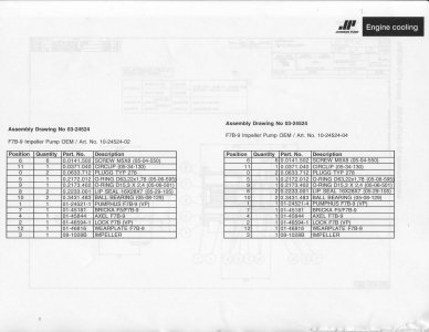

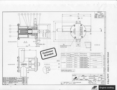

Yes, that O-ring stops any water that leaks past the water lip seal from running along the shaft, making it drip off, and getting near the oil seal. I am not convinced of its necessity. however, it should not be loose on the shaft and certainly should not be able to move along the shaft and touch the back of a lip seal. Sound like your O-ring was the wrong size. This is the drawing of the AD41 pump which I expect is the same and below is the parts list showing the size of the o-ring

There it is 👍, o ring should be 15.3 id, the ones in the aftermarket kits are clearly 16mm I’d and a loose fit on the shaft, I’ll grab the correct one and reassemble
