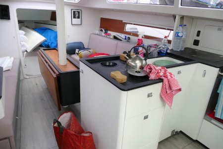

RM do a good line in ‘wedge in, ‘ U-shaped, galleys……
This one aboard a 1070+ (just in from the Acores, hence slight disarray). Companionway steps, out of shot, front right, together with drawer unit, providing corners to tuck into.
