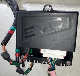

If you wanted to prove the helm station is good then you could switch the cables in the engine bay. If you could send some photos of the engine bay then it might be possible to spot the control units in question (called the PCU’s) and then advise from there

We switched the PCUs in the beginning without change but did not reset each to match that engine. I’m being told that had to be done. My person who fits in the bilge area where the PCUs are located isn’t available until next weekend. Both are mounted on the SB side of the engine compartment. The EVC system appears to be either an A or B Than you.
So if you switched the PCU’s but there was no change to the port side then they can be assumed to be ok
There are similar units at the helm called the HCUs, and this could be at fault. Easy to swap and yes, configuring to each engine is correct but for the symptoms you’ve reported, probably not required as if the other side doesn’t then show any life then you’ve probably cracked it.

Ok so they sound like they will be EVC-B. As you’ve got one gauge doing something it sounds like the power to the HCU is ok, so possibly just a faulty unit.

UPDATE: After switching the HCUs it was determined that the port engine HCU was defective. After purchasing a new one , all is well except the scar left by the cost of the new one. It is fixed though. Does anyone know if the old HCU is repairable just in case I have this issue again. Thank you.
