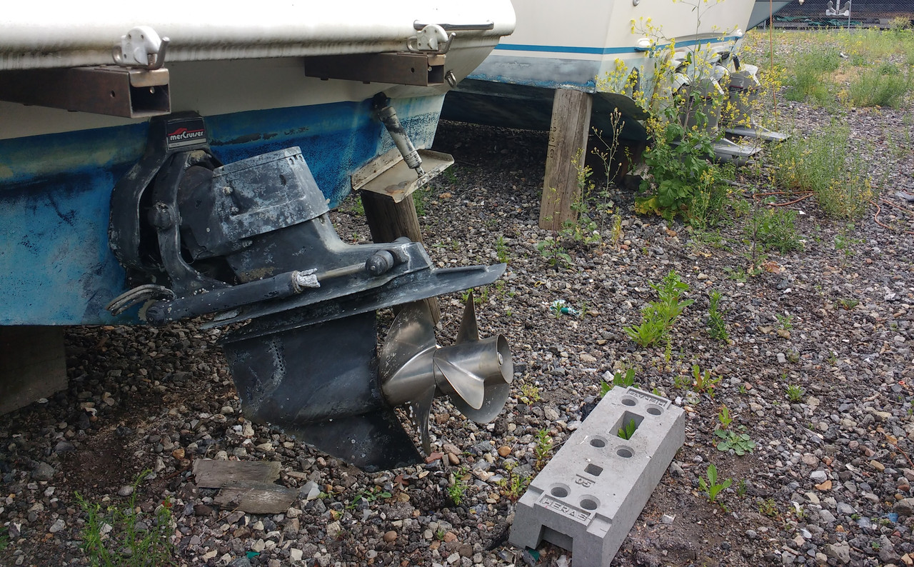

Among friends I have known greater issues with shaft drive than outdrive boats . But can honestly say I dont know anyone who owns a pod drive boat assuming we are excluding saildrives on yachts.
I have outdrives but if going bigger, which may never happen, I would prefer shaft drives all day long.
