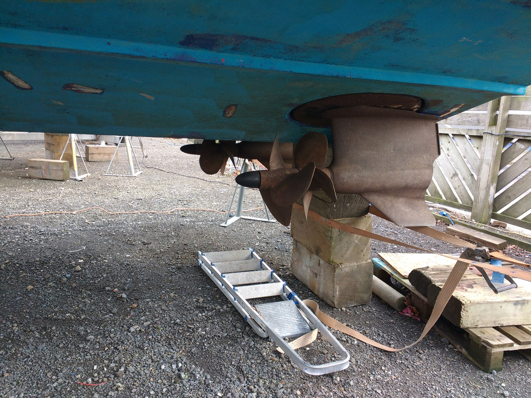

Having actually used and even considered buying a boat with IPS think it depends on what you want in a boat.
Found it no easier to moor in confined spaces than a boat with twin shafts, possibly it simply depends on your personal skills and confidence and what you are used to.
As for the much touted superior economy, fine if you go everywhere flat out.
Do what the majority do ie
mostly poodle around with the odd blast and suspect the fuel saving start to vanish.
Was actively looking at a Rodman 41 with a 1000 hour service coming up.
This was not a major service ?
The amount of money required for the bits and pieces plus of course the compulsory lift out killed this purchase stone dead.
14 litres of oil each engine @ £375.00 per 20 litres plus seals swap and other stuff.
There is a firm advertising a exchange refurbed IPS leg for around £ 25 K so the possibility of DIY is there.
Will shortly be helping to do a bit of basic work on a boat with IPS, A/F anodes etc, should be an interesting day.
