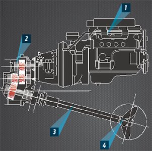

What is wrong with the good old V drive with the engine mounted the wrong way around with the gearbox at the front and the shafts running back under the engine?
Plenty .
In no particular order .
-Rearward weight distribution.
-Steeper shaft angles .
- End up with prop tunnels .
- more kit ( the v drive g box ) to go wrong …….potentially!
- difficult to access the stern gland
That enough 😀for now folks wanting more elaboration Ps run along and Google yourself .
