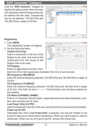

This is the page from the software programming manual for my Standard Horizon HX890E which allows the user to modify what channels are on the radio, this is for the EXPanded mode but the same can be done for the normal channels, you can add and delete from channel 0 on up

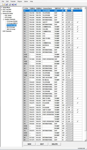

Just read from my radio: and right if I wanted to put channel 0 on my radio no problem - I have not done so.
