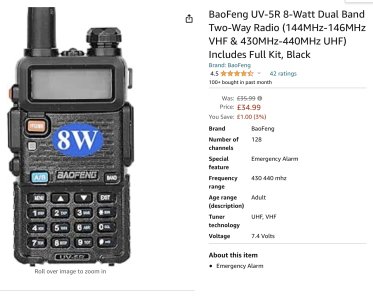

The UHF (Ultra High Frequency) band spans from 380-512MHz, exception being the 420-450MHz band, which is an Amateur Radio band and generally excluded from in-door RF coverage enhancement. 450-470 MHz – Land-Mobile Radio band.10 Oct 2018.
Frequencies used by that piece of equipment is slap bang in the middle of the UK Ham Radio UHF band :unsure:

The Baofeng radios (and many similar brands) are worth considering for inexpensive general communication. The rules vary depending on the country you are using them in and whether or not you hold a ham licence, but they are considerably more powerful than simple PMR walkie talkies and many will even transmit on marine VHF bands (perhaps in an emergency).
https://www.amazon.co.uk/BaoFeng-8-Watt-Two-Way-144MHz-146MHz-430MHz-440MHz/dp/B0C99TZQP3/ref=sr_1_1?crid=2I5C045Y2OO67&keywords=baofeng+uv5r&qid=1702318078&sprefix=beafoeng+uv5r,aps,367&sr=8-1
