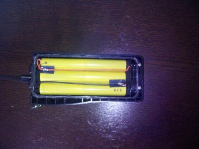

FWIW, I had a SH260 with original NiCd battery pack at its life end (+the alkaline emergency box was totally oxidized), I gently opened the battery box and found they were 3x2 AA batteries, so bought a generic 3x2 NiMH battery pack +NiMH usb charger, capacity went from 700mAh to 3000 (Chinese 3000, more realistically 2000-2500mAh). These voltages/battery packs are often found in model cars, they are made with single AA cells soldered together in various configurations. Cost maybe 20-30euro total, keep this old vhf (together with the new dsc one), better than throw everything away.
