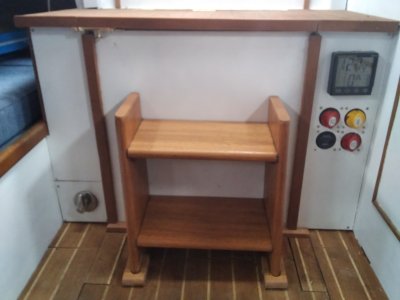

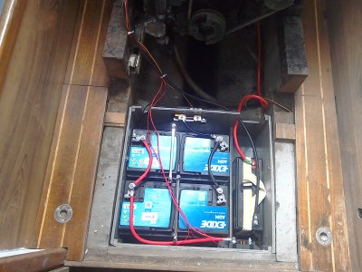

This is my current arrangement with 2 AGMs, Odyssey start battery, BEP cluster and NASA BM1 - but this is on a 31' with far more electrics including a fridge. NOt fully wired when the photo was taken OTT for your needs. The single battery will be more than adequate and doubt you will ever need a jump start. BTW although the GM can be started by hand in theory I only managed it once in the 10 years I had it.
