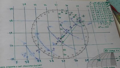

You don't need expensive charts for passage making, this is what I used pre GPS.
In very GPS days I used this, a laminated astro plotting sheet adapted to non-astro navigation, a way of drawing/erasing all sorts of lines, intervals, positions etc without spoiling a proper chart; not sure a plotter screen in the region 7-10" could hold all that info available at a single glance; pretty sure it can't, or by the time I digest the manual to obtain the same result I could well be already in port :)
It was a final 3-day run to the Azores, (very) bad weather expected around Horta, it helped figure out if a diversion to the southern islands was necessary.
