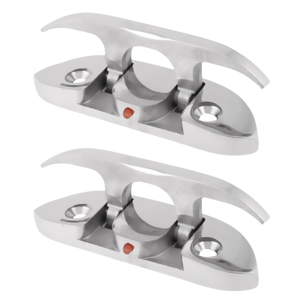

Just looking around and this came up :
2x Boat Accessories - Folding Cleat - Boat Cleat - Marine Boat Hardware 316 Stainless Steel | eBay
Folding cleat .... in a suitable size - fitted to outside of that alloy toe-rail ... open to use ... close to keep a flush line to the boat ...
Question is - how much stress could such put up with ?
Being stainless steel the strength would be the strength of the mounting.
Ifmounting on aluminium toe rail you would need to use an insulating base to reduce the aluminium corrosion
I assume that you are going to use s/s bolts. A bit of plastic milk bottle under the base will reduce corrosion plus sleeve the bolts, nylon washers, etc.
