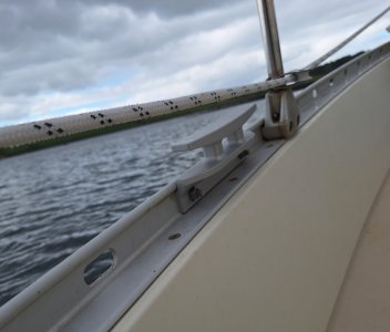

I have the same toerail and recently fitted one of these.Screenshot_20240608_113208_Gallery.jpg
It bolts to the toe rail, not through the deck, and I added it to use for pole downhauls and gybe preventer. The load is parallel to the toe rail.

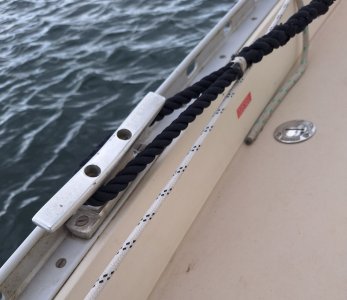

I already have one of these. It is bolted through the toerail and is very robust and used for springs and in this shot anchor bridle. Screenshot_20240608_113302_Gallery.jpg
The toe rail structure is strong but I can detect some tiny flexing when I lean on the stanchions which attach to it. I would definitely bolt through the toerail or deck to mount a cleat I wanted to moor with. My main cleat (2nd photo) has a separate alloy platform through bolted in between the toerail bolts. The cleat then bolts onto the platform. Ropes do not foul them - they are usually concentrating on the anchor winch!

Your 2nd photo is basically what I have up at the foredeck ... mine have 2 bolts through deck..... you can just see in my photo.
The boat is setup as a typical Swedish island hopper ... only about half the cleating I would want !!

I have the same toerail and recently fitted one of these.View attachment 178190
I have two of these, and they are immensely strong, easily taking the strain of stopping the boat using a spring. I'd happily use them to attach a towing bridle. But on my Moody, the toerail is part of the deck to hull joint, so it's far stronger than bolting through the deck, especially for fore and aft forces. Of course these cleats are as strong as the toerail, so their strength will depend entirely on the strength of the toerail.
Supertramp
18 Jul 2020
943
Halifax
My toerail is also through the hull deck join and you reassure me that they should be fine for fore and aft spring use. As should Refueler's folding cleat.
