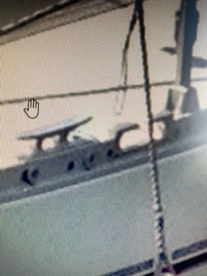

For example of the mooring arrangement - here's my 38 racer moored bow to pontoon and line back to buoy.
