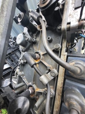

Quick update.
Went to see the boat, the boat itself is in good nic, very clean & the trailer is also in very good condition.
However, the engine wouldn't start as the trim motor on the boat was broken. There is a small device at the back of the boat
that was connected to the battery, that then connected to the trim motor, they couldnt get this work. The trim motor itself, they said worked, and they did get it to trim down a little while I was there.
I dont know what the device was, just looked like a small balck box with 4 connectors coming out of it. They had bought a new one, but it was the wrong type.The steering wheel also didnt turn but
the guy said that the motor needed to be trimed down for the stearing to work and for the engine to start, is this correct?
The guy was really apologeit and said they'd get it working for me, they also found water on the land and said if I brought a barrel they'd run it in water for me.
They do seem genuine but really not set up to be selling this correcfly. It's stored on a borrowed plot of land and they don't spen any time out there to prep' it for viewing.
Link to it trying to start
