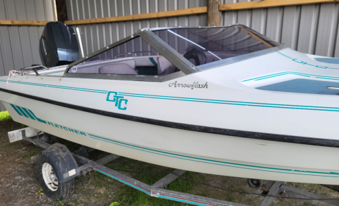

Bought thisn today, Fletcher speedboat for sale in Kildare for €3,000 on DoneDeal
Engine is in good shape, needs a service but very happy with it and price.
Interier needs to be patched but apart from that, all seems sound.

Me thinks a Fletcher GTO 150 Arrowflash on a Fletcher trailer with a 75 hp Mariner 2-stroke. There was a photo of some handbook, receipts and documents also.
Is it this one ? If it is, one of the nicest small fletchers, I think. Almost sure she’s a fletcher arrow flash 147 or 147 gto they might just be called. Predecessor to the arrow flash 15 I think. Great wee hulls. 75-90hp is ideal for them I think. Was recently in an arrow flash 15 with a 75 merc. She went really well, I thought. Round about the 40mph mark or just over I think.

It looks identical and has the Arrowflash decor below the A-pillar (car-term), so unless it's a retrofit, it's genuine.
The photo of the transom confirmed a nice hull. The paperwork will tell.
Yeah. I’d say she is an arrow flash, but an arrow flash 147 model. Think I may have mentioned in a post earlier. The 15 has a round windscreen I’m sure. This was the earlier arrowflash I’m sure. Arrow flash are usually easily set apart from just about all of the rest around that size, by the wee prominent raised or featured shape they have at each side right towards the rear and just above the water line. As far as I know, every arrow flash had that feature. Very very few other models did. With maybe one or possibly two other models rarely featuring it. The much larger 199 and the 161 had it I think. Not sure any others ever did. Anyway. Geekery session over, haha.

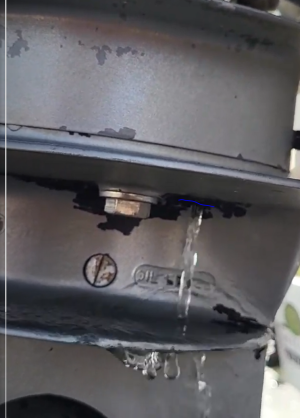

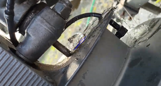

I didnt know water was supposed to come out of here? Is this right?

It is not very easy to see in your short clip, but if water comes up around the gear-shift shaft (connecting to the gearbox in the bottom of the leg), something is wrong.
The drive shaft goes down inside the leg, through the sea water pump and into the gearbox. I'd suggest the water pump is leaking heavily, but since the impeller inside the pump is a service part anyway (manufacturers recommend annual replacement), you should replace it and at the same time fix the other issue(s). And change gear oil.

The water was coming from holes just above and below the the part where the leg connects, not from the actual connection.
Would it need to be a whole water pump replacement or just the housing? I thought the pump looked good because water was pumping well.
I'll be changing the impeller tomorrow as you recommend. WATER PUMP SERVICE KIT DO we think this kit will sort it?
Here are the stills of where the water is coming from. There are actualy holes that the water comes out of.
