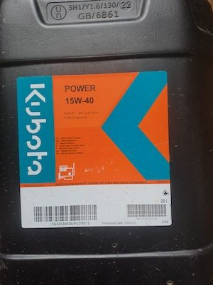

I buy mine from the nearest Kubota dealer: Kubota Power 15W-40 to CI-4 (see pic). 20 litres over the counter costs about £85. It's made by Total I believe.
Don't know where in the Highlands you are, but HRN Tractors supply it (branches in Stirling, Kinloss, Aberdeen and several others).
