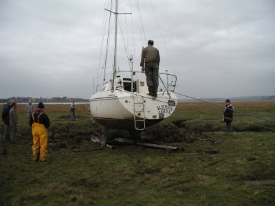

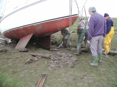

Here
We got this one back in the water when it was washed up on a very high tide in a gale. Luckily it had a rudder that was removable.

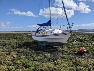

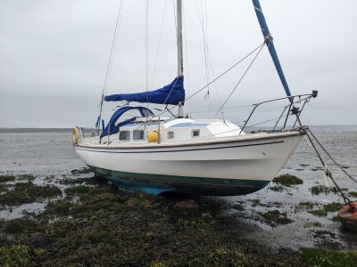

A shame and it will give real difficulty getting her off apart from the inevitable scrotes taking equipment off her if left for any time. I hope it works out ok.
A guy in my old sailing club bought a very nice Prout 37 that had similarly pulled the mooring in Poole Harbour and after several attempts to refloat her she was writtien off by the insurers as unsalvagable. He eventially retrieved her with a large number of buoayancy bags strapped between the hulls.
I am surprised there is no back anchor line to stop it being blown further aground but perhaps it was anchored on the Lymington side and there is deeper water nearer that side?

I went past it today on daily dogwalk ... and it was pretty well embedded at high tide so I don't think it's going anywhere soon .... the anchor was out with a lot of chain in the wrong direction ie parallel with the shore...but I don't think it would make any difference. looks like mooring dragged/broke free from middle of Keyhaven river. I rang Keyhaven yacht club yesterday and apparently 'owner is aware'.

The Air bag method is probably the best here ... less damaging.
Whats needed is low pressure weather system ... spring tide ... lots of drums / air bags forced under her and between keels - so when tide comes in she lifts ... while waiting lay out lines / anchors and dig around the keels to reduce the 'suction' .....

Get four 200lt barrels, lash them together under the boat either side in pairs tight as poss. Ropes over the top to keep them in place. 800kg of extra buoyancy might do it

Back to my post #15 ... I would suggest more than that ... and to get as low as possible and UNDER the boat as possible ...
I would be considering digging out and strapping a barrel across the front of the bilge keels under fwd section of boat ... and similarly aft if possible ...
Then think about as many as possible low down along the sides with underhull straps to stop them riding up hull ...
Its as well to consider what the actual bouyancy of each barrel will be. Under the hull could be in high % region of barrel volume ... but side slung will be at best 30 - 40% of barrel volume.
Lets say you have one dug in under hull between keels ... lets say 100% bouyancy. 200kg ( we will ignore the 1.0235 factor of SW ).
Under fwd hull ... ~ 75% ... 150kg
Under aft hull ... ~ 80% .. 160kg
Along sides ... lets say 4 each side .. each about 40% ... 8 x 80kg = 640kg
Total bouyancy about 1150kgs ....
That means you would need about a 2ft depth of water at the boat given its usual draft of about 3ft.
