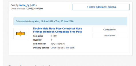

I have never had any problem at all with genuine Hozelock fitting but this supposedly compatible connector that I bought via eBay a while ago leaked badly and I obtained a full refund.
