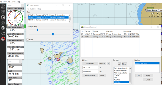

Rather than start a new thread for ascat which no one will be much interested in, for anyone who actually is, ascat images can be downloaded & viewed in opencpn with the wfax plugin. Ascat is satellite wind measurements available online. The Advanced Scatterometer (ASCAT) Data Products

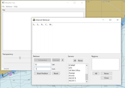

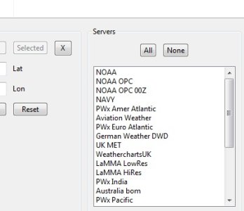

Hello GHA,
did you add the Ascat download Server yourself? I have clicked "Update the data source" (plus restarted Opencpn etc) it lists many servers but not Ascat, even at the bottom of the list.

It was in the built in server list though not every lat/long seems to list them, 52n , 1W does but 52n 0 doesn't.

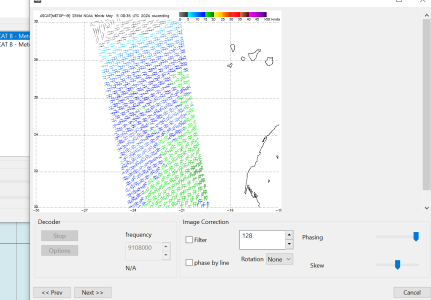

also you might need to calibrate the image, double click the file name which should open a new window, first page should be ok with defaults
then next to second page & set read and green cross hairs to lat & long of the image, then next to exit & imae should show on chart
