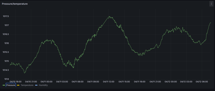

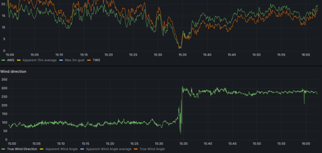

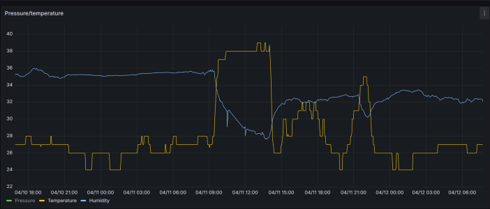

Nothing to do with which app is best but what an odd bit of weather it was today!
Forecast was gusty overnight & today, night was calm then today wind just appeared and temperature shot up, like in a minute. Thermometer is in the cv7 wind sensor which seems to take a little while to display changes, might take a little while for the whole unit to warm up, but the change was much faster that the graph. Then sailing along the SW coast of Gran Canaria in like a boat length the wind stopped & it was like walking through a door into an air conditioned hotel in Dubai, instantly 12degC cooler & wind did a 180. Very hazy & dusty sand everywhere so warm wind prob straight from the Sahara. Assuming most likely the wind splitting around the mountains & I sailed across where they met, but extraordinary such a large temperature drop in an instant! 🥵🥶
Looks like it took about 5 minutes to go through the boundary between the 2 blobs of air but the spike just before 2pm shows how instant it was when the temperature changed>

I will start with what you may think an insult. Are your temperature readings correct? The SST in the area is about 20degC. What sea temp are you measuring`? 20deg is about the seasonal norm.Your air temp started off at 28deg. And rose to 38deg. That seems extraordinary.
Having said that, the temperature increase occurred when the wind went to the WNW. That looks like a katabatic effect. The cooling late on was, presumably, as you move out of the katabatically warmed air.
You could contact AEMeT and ask for an opinion. They might want a little more info, wind speed and pressure, for example. You might, also contact the R Met Soc with a description. Whichever, I suggest thst you calibrate your temperature sensor against a mercury in glass thermometer.

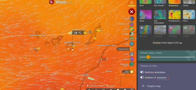

Pretty sure the thermometer in the cv7 is accurate to within a degree or so, usually tallies up well with any nearby airport reports though not instant. Sea temperature is around 21DegC. And it really did happen, the first temperature rise was not instant but sailing along the coast the change was instant, it was a blast of what felt like cold air from hot very much like walking from a hot tropical day to standing in front of an air conditioner. And stayed cool. Yes, extraordinary, never experienced anything like that before!

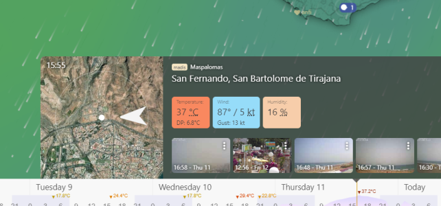

Nearest windy recording station is round the east coast but show that it was indeed hot round there, pity the one to the west is offline at the moment. >
Windy shows it forecast as 28Deg at 3am this morning 2000 feet up.
Weather does some weird stuff sometimes 🙂
I am not doubting that it happened. I am saying that any meteorologist would query the calibration. Your values recorded locally do support the value. Katabatic effect would seem the most likely. A good MSc dissertation topic.

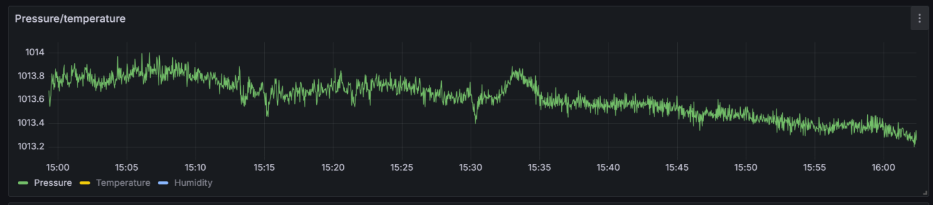

Keep forgetting that the little barometer chip does relative humidity as well, surprised it went down, could that be because the temperature went up so much? Certainly felt humid & sticky when the heat hit. Sensor is inside the chart table which might explain the lag in readings from what it felt like which was very quick.
No big change in pressure >
Yes. In the Foehn effect the rising air, once it has reached the condensation level, cools at the wet adiabatic rate. When the air descends, it warms but when water drops have evaporated, it warms st the dry adiabatic rate. The RH decreases a the warming is marked Aberdeen gets abnormally warm days in these situations. N Wales does in southerlies.
I still do not understand by the temperature was so high at sunrise but see that the whole area was warm.

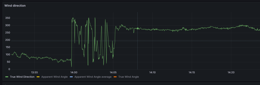

Carrying this on a bit, similar today & question is - where does the air go? Must go up? No wind at the boundary- anyway, sailing today enjoying a nice downwind breeze then it died & within about 50m it reversed! Pretty much exactly 180Deg >
Tiny little spike in pressure >
Temperature dipped just 1 degc for a few minutes.
No idea how this works but fascinating!! 😎

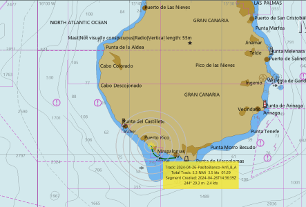

Where were you relative to the island and how near your previous track?
GHA
26 Jun 2013
12,444
Hopefully somewhere warm

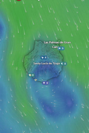

Slightly to the east of previous & a mile or so off >
As you no doubt know the Canaries are famous for the wind acceleration zones, so far I'm visualizing a high pressure being created north of the island when the wind hits the mountains and a low pressure downwind, then the wind is accelerated down each side of the island and what I went through was where it meets again? Guessing though, if so the air must go up when it meets? Dunno, but would be nice to have a better feel for what goes on 😎
Todays ecnwf which looks pretty similar >
Certainly an interesting effect. Where the sir comes round the island and you get convergence, the sir must go up. But, do you see any cloud? It might be interesting to show to a university. Is there one in the Canary is? It wold be a nice MSc project.
