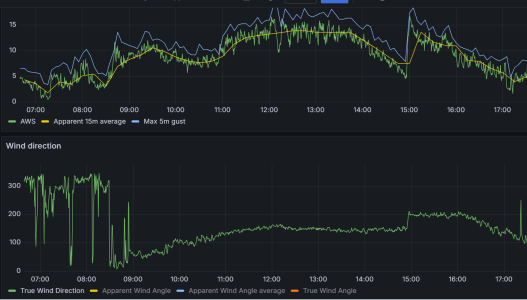

As ECMWF Effective resolution is 0.5 degrees that is difficult to explain. From La Rochelle northward or, at least north of Ile d’Yeu we often found that the GFS got the sea breeze effect well. UKV can get the Solent sea breezes but may not/
Not happening in the next few days so can't get a screen shot but somehow it manages it. And as you know onboard the trusty raspberry pi records it all, this from last week shows whatever is happening quite well building in the morning & going to the south. Then something happens at 15:00...🤔 1712226453382.png
Could stare at this stuff for hours 😎
Though not sure if it's just sea breeze, very mountainous here, some sort of vortex effect maybe?
Though these days in a new anchorage all the models are guilty of being wrong til proven otherwise 😁
Useful is maybe a better description than "right"....

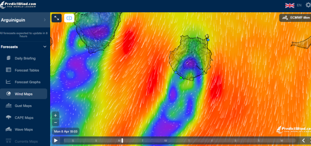

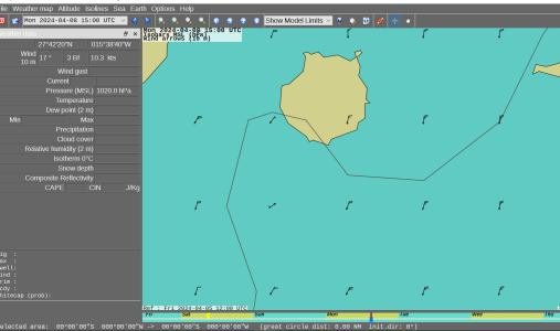

The windy 9Km ecmwf does seem to usually be very good at picking up the afternoon onshore winds which pick up over about a 15Nm southern coast here in Gran Canaria which presumably would be missing from the 0.4Deg model.
Going back to this one, the opencpn downloaded 0.4deg for monday afternoon show no onshore wind, curser isn't shown on the screengrab but is around the centre of the south of the island >
Northerly 10Kts.
And windy ecmwf shows gusting 23Kts from the south.
We`ll see over the next few days but run shore to the supermarket will be planned for the mornings next week, it's usually right 🙂
Just sharing what happens, next anchorage it might not be useful.
