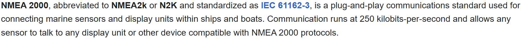

NMEA2000 is 250 kbps ......

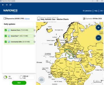

The navionics map updates on my plotter are approx 550MB and it estimates 16 mins to write via the USB3 Card Reader. .... it actually took around 3-4 mins.

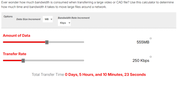

Over a 250kbps NMEA2000 network, assuming it can use the full bandwidth (which it can't for numerous technical reasons) the transfer would take over 5 hours.
