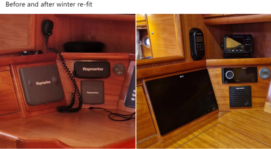

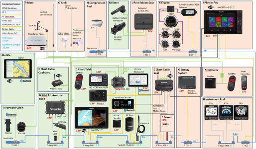

I have Navionics maps running on the system below, you can plan using the tablet on the sofa (Navionics App) and then sync over WiFi with the plotters to transfer routes, waypoints etc. which is a nice feature, nicer than being huddled over a cockpit plotter in the rain entering waypoints.
Be aware that to do this you need 2 navionics subscriptions, one for the plotter and one for the mobile device.
Get a plotter with buttons if fitted in the cockpit IMO .... when the boat is tossing around, using a touch screen is a pita - you have one hand on the wheel, one hand to brace, and the boat is heaving around - and then you're expected to pinch and zoom on a touch screen to get your chart magnified? Or hit a little icon to bring up some important information about the ship which is bearing down on you?. I guarantee this will happen at the most inopportune moments, you will miss your target and trigger some other function instead, causing panic as you desperately try to get back to your original display.
Buttons + Touch is perfect IMO, buttons alone are excellent but clunky, but touch alone, not ideal because touch doesn't suit more extreme conditions involving random movement.
The OP didn't mention budget so, ... best budget option IMO ..... (almost bought one for my last boat but sold the boat instead.)
The ONWA KP27-A 7inch with AIS transceiver - 7" KP-27A with AIS Transceiver. Latest model .... unbeatable value IMO. There are WiFi dongles available but not sure it syncs routes etc. with the Navionics App, perhaps @Refueler or @Irish Rover can answer in detail.
Best bells an whistles option IMO, a complete Raymarine system (my winter refit project) with the exception of the AIS as I wanted a separate screen for it ......
