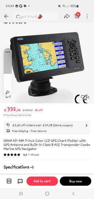

Hi do you mean one of these? Insane price for an integrated ais transponder.
What are the included charts like?

If in UK - ONLY buy ONWA from Aves Marine - he's the official dealer and will support you 101%. Do not buy via eBay etc. .... seriously.
I have the 39A and I really like it .. AIS is Class B+ ..... first versions of the 39A were Class B ... but were changed in its early production.
My 39A feeds all data incl AIS to my NMEA2WiFi plexor which then outputs all data to WiFi ... USB and NMEA0183. I can then connect tablet .. Echomap .. phone .. PC and display all data ... I could feed my Depth from the B&G system if I wanted - but I like simple !!
But today - I would look at the newer models ... the 39A is a little dated now being a box unit instead of the slim later gear.
The Charts ? I have K2 and K3 charts on SD card for it .. and I can navigate with confidence ... they do not have updates - so you are relying on increasingly aged charts. But I have full professional Charting with updates same as ships ... I have Navionics on tablet / phone ... and so far I have not noted any significant difference to cause me to worry about the K2 or K3 charts. K2 is recc'd on the 39A as its processor slows on the K3 version.
You have option to use Navionics (+) charting ... check the compatibility as Garmin really screwed it up by coding Navionics in two forms ... Garmin form and non Garmin ... obviously trying to lock users into their gear.
