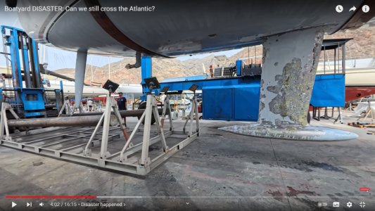

That's not what happened- the boat was sat down on the hard with the stern lower that the bow, placing too high a load on the aft end of the hull/keel joint.
Missed that and watched the video a couple of times ... my bad. That would do it on this particular boat. Looks like the grid was bonded rather than laminated to the hull and it seems like the the bonding gave way. Give it a few years and the technology will improve until bonding is stronger and more flexible making failure less likely. May eventually end up being better than laminating.
On the plus side, the repair will take a few months but will almost certainly result in the grid being laminated to the hull as the grid can't be re-bonded effectively ... so it will be improved after the repairs.
This video is a good explanation, and there are also videos in the series showing the repairs from start to finish.
My two take-aways are - get an AWB with a laminated grid - no guarantee but seems to fare better than just bonding, and the second - understand the risks of putting your boat in charter.

Shame no footage seams to exist of the boat in the slings at an angle and it being placed on the keel. Sounds a wee bit negligent if this happened. A surveyor will hopefully determine if previous damage had occured.

There is no evidence in the video that the yard did anything unusual, quite the opposite. The keel was rested on the flat for pressure washing and the cradle appears perfectly adequate and well constructed, the ground is flat, the yard is tidy.
The idea that you could expect to damage a boat of that type by resting it on the end of the torpedo keel is also fanciful. A couple of common house bricks under the tip should only cant the boat forward or back till it balanced - not destroy the structure.
To design it otherwise would mean a warning and ban of ever drying out alongside a harbour wall, for example.
As mentioned earlier, dropping the boat is another matter, there is no suggestion that this happened.

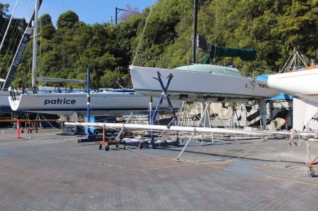

Well here are 2, twitchy masts, beamy, not much headroom, slender keels with big bulbs.
We were there doing our own AF and the yard had a complete cross section of vessels: Navy landing craft, historic long keelers, a large tri, us - and a large number of yachts with twitchy masts, Patrice's mast is in the forground and her slender keel was off having some work done.
How many pictures would suffice? I have a rather large number of pictures - there were more twitchy keels than anything else.
I might add - if you think only Europeans build performance yachts with slender keels you really need to get out more.
We were there doing our own AF and the yard had a complete cross section of vessels: Navy landing craft, historic long keelers, a large tri, us - and a large number of yachts with twitchy masts, Patrice's mast is in the forground and slender keels. How many pictures would suffice?
I'm not too sure why you think only Europeans build yachts with slim keels, I suspect you need to get out more.

Its not clear from the video that the boat was at sufficient angle in the slings to put an unfair load on the keel. Instead of concentrating on preparing a social media post the owner should have been paying critical attention to his boat.
They specifically point out on the video that they didn't capture the critical moment where the boat was damaged, because they were too busy attending to the lift.
