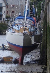

What do you think of this one?
Quite a few boats lost their keels one of which is the Beneteau 40.7 with similar keel design. Moving the Ballast to the bottom of the keel is a great way to reduce displacement hence faster hulls but the loading on the hull is amplified and grounding catastrophic. How many are out there that have structural damage hidden from inspection. I would be very worried. :oops:

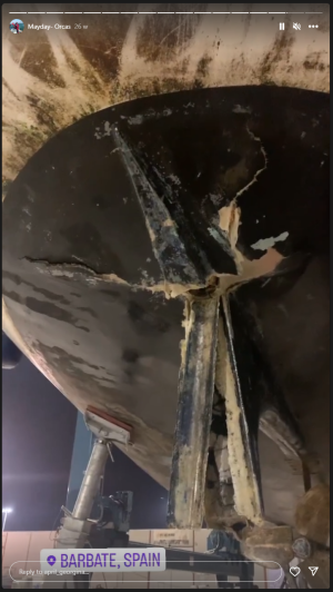

A 66ft Moody "Mustique" had its skeg hung rudder ripped off by an Orca and would have sunk if a helicopter hadn't delivered high capacity pumps to keep it afloat until it could be lifted out.
If keel/grid damage was really a major factor in yacht sinkings or claims, then modern boats would be priced accordingly by the insurance companies - but they're not.

I take quite a bit of interest in Keel design (yes I have also sailed sailing boats too) and my perception is that this keel design works within the confines of its intended loadings. I'm sure in 'normal' use most will work very well but they are very unforgiving if they are subjected to loads outside of that 'window' i.e. an uneven loading of the boat onto its keel, or hitting a submerged object out at sea. It's all a compromise but I can see why for many sailors they want something that can deal with 'unexpected' loads better when on ocean / offshore passages. Peace of mind does improve the whole sailing experience for me.
Over the last 60 odd years I have seen quite a few boats hitting bricks. Sometimes heavily. I have hit a few myself. Nearly all of these incidents involved boats that belonged to that group that would be referred to as "older". And I have seen for myself that the damage caused by a grounding heavy enough to cause me to bang my head on a solid bit of the boat and draw blood (lots!) was minimal; some denting in the lead of the keel. I have never seen the sort of structural damage discussed in this thread. A further example can be found on YouTube if you search for the video of the Tobermory race made as a programme by the BBC. At the start of the second leg of the race, from Crinan, one boat grounds heavily on the Black Rock. A voice on the recording reveals that it is not the first time that this boat has run aground. Yet the yacht goes on to complete the race. When I saw it out of the water at the end of the season the only evidence of the collision was some missing antifouling from the keel and some depression in the cast steel where it had hit. I think that the rock came off worst.
Normal use for a boat designed for racing and normal use for a cruising boat can be quite different. The racing boat is more likely to be carefully pampered and its bottom cleaned regularly. If it does touch the bottom a conscientious owner will inspect for damage.
Certainly the normal way I use my cruising boats, going into interesting anchorages and amongst rocky places risks unintentional groundings. I have even managed to touch the bottom in Norwegian fjords a couple of times by sailing very close to the shore to make the most of a favourable slant beating out against the increasing sea breeze. Drying out alongside walls or piles for a scrub or prop clean etc or being lifted out in different places was also normal usage.
All boats are compromises and the normal demands of a cruising boat require a more robust underwater structure than an inshore round the buoys racer. However, racers tend to set the fashion, be it rule beating deck sweeping genoas with big overlaps, yawl mizzens for unrated sail area, or narrow keels that allow the boat to turn in its own length. As some of the earlier posts imply its a case of the owner selecting a suitable design for its intended use. From this perspective the fault lies with the owners of the vessel. They chose the boat for their intended usage and given its somewhat unusual design features should have been proactive in supervising the lift.
I was closely watching one of my boats being moved in a south coast of England yard. A passing owner told me to walk away and leave it to the guys. My reply "I am responsible for the safety of the boat". In practice I got on very well with the yard guys, they were professional so I did not need to intervene other than to ensure they could do their job as easily as possible, and they recognised that I knew what needed doing. More often I have hired a construction company crane and driver and its been my responsibility to direct and check the entire operation.
Down our neck of the woods where racing fin keeled boats in shallow strong tidal waters is a popular pastimes we have seen plenty of examples of severe structural damage from groundings - not just modern boats but going back to the 1970s when bolt on fin keels started to appear in numbers.
It is inevitable with the type of high aspect ratio keel on the boat in question that the structure needs to absorb any abnormal loads and lowering it onto the aft part of the torpedo ballast bulb is abnormal as you can get.
